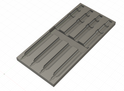

If I have Component A and Component B partially overlapping, and use the Combine feature, I can cut the portion of Component B that is overlapping with Component A away, leaving a cutout area in Component A. I would like to create a pattern of this cut so I have multiple instances of this cutout along Component A, but when I try to do this by choosing body or component, it does not work. I have to choose all the newly made faces of the cutout area. Am I doing something wrong or is this the only way to complete this operation? I know I could make copies of Component B and do the pattern first and then use combine to take all the instances of B away from A, but this creates a bunch of extra instances that clutter up my browser so I'm trying to avoid this.

Thank you. I tried adjust and identical, but forgot to try optomized. I started by using the rectangular pattern, but I figured since I only need one row of copies, the pattern on path might make more sense. But I'd be happy using either option.
The reason I am using the combine feature is because I have a slightly more complex component and I wanted to partially cut out that component from another to make an indentation. I have attached an image.

The sweep tool with the ‘Solid Sweep’ option is ideal for your purpose.
You can use it to create customised segments for tools.
In the screencast, I show an example where the cut covers the entire tool height.
