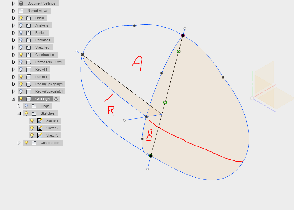

I would like to generate a surface which is curved in two axis. Could you give me a hint how to solve this problem? See also the linked model with the defined profiles / paths: http://a360.co/2qQnKxg

Forgot to mention that I tried to generate the surface with the loft function.

Quite a few issues, Sketch > Project > Intersect, will become your friend, for loft corners.
As I don't know your design intention, I have taken a few pics, and try to explain why Fusion will not loft for you.
The section marked with x, lower rail, is a duplicate rail, on top of itself, and causing selection problems.
The sharp corner in the top area, is not allowed as a rail, but can be used as it is, if you change to profile sketch1, then Sketch 2, with top of sketch 3 as rail.
You can't select the left half of Sketch1 as profile, because it is not shaded, need to correct that.
You can not loft anything except my preview at the moment because sketch 2 corners are not connected to Sketch 1 at both ends, need to be fixed.
When fixing Sketch 2, you can then get the kink in sketch1 to work by lofting A half of Sketch 1, to all of Sketch 2, with Sketch 3 as rail.
If you change Sketch 3 to go right across and break Sketch 1 at the top and bottom, you can get one piece Loft.

Found more duplicate lines in sketch 1, fixed that by having one curve in all positions,
Cut the top and bottom curve at the centre line, then moved the Sketch two end points, to the intersection points.
Lofted with out sketch3 rail and looks like it will work as expected.
Might help....

Your last picture locks pretty much like the shape I would like to get. Cool and thank you for your support. 🙂
