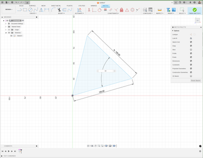

I am trying to create a triangle, then a smaller triangle cut out of the center of it. I'm struggling with getting everything equal and aligned. Anyone have any advice?

You did not specify how you want the inside triangle aligned to the outside one as there are many possibilities.  The video may give you some ideas.  As I mentioned in the video, once the polygon is placed, you cannot edit the number of sides only the size.  I have completed the model with two extrusions, it is attached.

Start a new Sketch on one of the planes, Red Green is XY but any will do. Select the
Line tool and draw any triangle. I would suggest that your fist point is on the Origin.
Notice that the inside of the triangle is blue - this means that it is a Closed Shape.
Any Closed Shape will be blue and can be Extruded.
Also notice that the Lines of your triangle are blue and in the Browser tree on the
left hand side where it says Sketch there is a little Pencil icon. This means that your
sketch is NOT Fully Defined and Constrained.
To start Constraining your sketch, select the Dimension tool.
Highlight the bottom line of the triangle by hovering the mouse over it and it goes
Dark Blue, click andpull the mouse down a bit. This will set up a smaller line from
each end of that side of the triangle with a number in it. Make sure that this line is
Parrallel to the side of the triangle you are dimensioning. Click when it is where
you can see it and hit enter, or enter an exact value then hit enter.
You have now set the length of the bottom line of the triangle. You can change this
by clicking on it at any time. Everything is still blue but that is ok for now.
Still with the Dimension tool, highlight and select the line to the Right and click
to make the dimension, but this time instead of entering a value, click on the
value of the first line and it will change to d1, then hit enter. We have just created
a Parameter with the value of d1. It will be whatever the value of d1 is, so if we edit
d1 then both sides will change to that value.
One side left to do.
fx: 100.00 means that the length of side 2 is a parameter and is 100 long.
Now lets use a different parameter to finish defining our triangle. With the Dimension
tool, click on the bottom line and move the mouse to click on the 2nd line and then
move the mouse towards the third side. You should see an Angle dimension pop up.
Click it where you want it and set it to 60 degrees.

tomcass240
Thank you.
Message 6 of 8
tomcass240
Is there any way to draw the triangle a specific height, aligned with the x axis? I'm struggling to place it on the x-axis, I have to keep redrawing with random center points til it's approximately the right height with the base on the x-axis. It'd be so much easier if I could just make an equilateral triangle by specifying it's actual height rather than the radius of the circle that circumscribes it. I can't even move the sketch after I place it. Clicking move doesn't move the sketch in the same way most people think about moving. It just kind of tilts the triangle instead.
Message 7 of 8
Drewpan
Draw a line in space roughly parallel to the x-axis. Dimension it whatever length that you want.
Draw the other two sides of the triangle. Place a Horizontal constraint on the first line. Dimension
the second line to be the same length as the first by clicking onto the Value of the first dimension.
You will also need a 60 degree angle dimension between the first two lines.
This should immediately snap to an equilateral triangle, parallel to the x-axis and should be able
to be dragged wherever you want.
Cheers
Andrew
