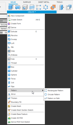

Have you tried a circular pattern the a rectangular pattern to create the 2 layers of planks? All the vertical layers would be the same, I noticed you've rotated the second layer 90°.

Thank you! That's the magic! It works for the first layer and from there I can use the rectangular pattern for the third layer.
Now I only have to figure out how to make the second layer dependent from the first layer as it is mirrored along a vertical plane. (Not rotated 90°, because that would not change anything, but you saw that correctly, that there is a difference.
