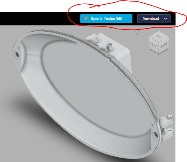

TheCADWhisperer
"Solidified" in Autodesk Inventor Professional.
https://a360.co/2PdXV3O
Would probably be 100 times smaller file size if modeled natively in Fusion rather than converting stl.
