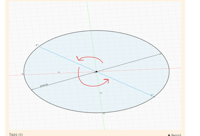

A side note, why can't I constrain a line that:
  1. Connects to both sides of an already constrained circle
  2. The midpoint passes through the centre of the circle
See this photo, there is coincidence constraints at both ends of the blue line and a midpoint constraint to the centre of the circle. I would expect that to be enough?
Message 11 of 19
laughingcreek
what's controlling the angle?
