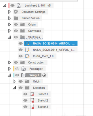

When I created the Planes to place the Airfoils, I created them in my Top Level. I thought at the time that they are just
Planes, not realising that the Airfoil Shapes are generated as Sketches WHERE the planes are located in the design.
After I had positioned the Airfoils in the correct place on the Canvases I realised where the new Sketches ended up.
This occurred even though the Active Component was the Wing Assembly I had created and NOT the Top Level. So
what I have now is three orphan Sketches in my Top Level that I really want in the Wing Assembly. I can live with
this but it annoys me.
Can someone confirm how to fix this? I tried selecting and moving the Sketches but it doesn't work. I am about to
try rolling back the Timeline and setting the Active Component to the Wing Assembly THEN creating the Planes,
but before I do that I want to check if that is the correct way to fix it.

Easy one first.
Timeline to end of file.
Expand the browser arrows, to see everything.
Select Top construction plane in the list, and click drag to the wing Component.
When I did this, Fusion was good enough to know I was going to do that again, but decided to do them all, along with the sketches.
