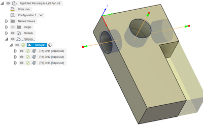

In the mirror command, there should be the possibility to convert a right part to a left part by means of a mirror.
Now a copy is always created when mirroring and thus the possibility to convert a right part to a left part is missing, so that all subsequent features remain referenced.
Christoph
