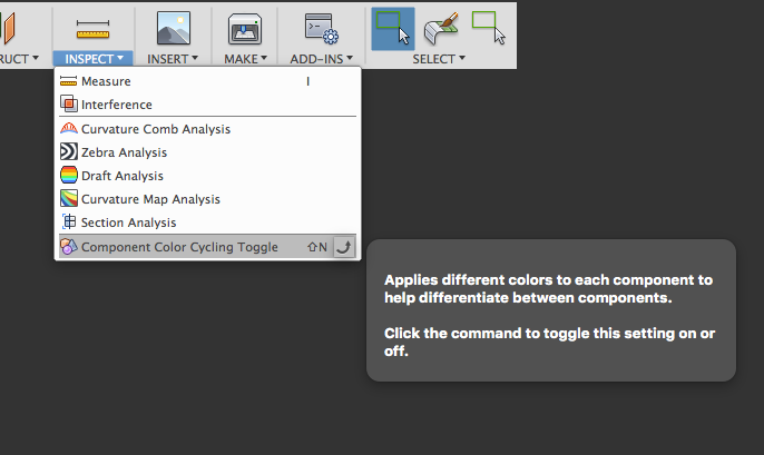

If you want the components automatically color coded, this can be enabled in the "Inspect menu"
