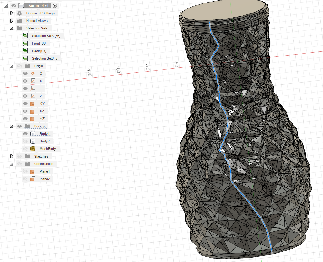

So I have this pot mesh (stl) that was then converted to BREP. My end goal is to create a 3d printable Pot mold, so I need to split this beast into two halves.
However, I am trying to avoid flashing lines, so I've created a rather complex selection lines which I then created a selection set. I have done this on both sides of the pot.
My question is, how I can split this pot using those lines. I've attached a screen shot of one of the selections. I tried doing a Surface extrude on the line, no dice.
In a previous model I was actually able to create a Loft (using lines that were twisted) and it magically worked, but that was modeled from scratch, not imported from an STL..
Any ideas welcome! Thanks!

Try splitting it in half first at 90 degrees to your desired split.  Split each half with your multi-segment line.  Combine the appropriate bodies together for the mold.

By splitting it in half at 90 degrees to your desired split, the desired split will only cut one side of the model.  You'll need to create separate (desired) split paths for both halves.

p.s. There is no lofting required for the Split Body command.  Simply select the line as the Splitting Tool.

My fault, I definitely didn't mean to say Loft. Sweep is what I used!! So you did split body and just chained those up the pot? Either way your breadcrumb got me there, and yup had to join up quarters all the same. Probably no way around that without cutting faces I think. ¯\_(ツ)_/¯
Thanks again @etfrench  & @TheCADWhisperer  Here's how she came out if you're curious. test print seems ok so far lol

You don't have to create an object to do the cutting.  Just select the line as the Splitting Tool.
