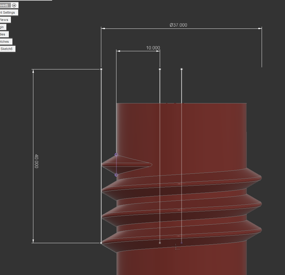

I'm trying to recreate a coarse thread with the following characteristics:
Roughly:
minor diameter 30mm
major diameter 37mm
pitch 6mm
When clicking on the 'create thread option', it defaults to a M32x2 with a much shallower (steeper?) pitch, meaning I have way more threads than I'd like. The part I'm helping reverse engineer is a 3d printed part with low tolerances, and can be tightened with 4 or 5 turns of the hand as opposed to 20 etc with a finer thread.
What is the coarsest thread available in the create thread tool?
Do I have any easier options than the custom thread profile creation (heard something about xml files or something in someone's earlier post).
Attached images of the part I'm trying to reverse engineer vs the too many threads I'm getting with the create thread tool.

Have you tried using the coil feature? You'll need to experiment the section size and diameters a bit but might do what you want. Just create it around a cylinder.

If you try this, see attached file for some pointers and an idea for the run out at the end of the thread.
I created a sketch with a line 5mm from the intersection between the thread and the cylinder to use in a rotate feature.

Adding the fillet reduces to OD a bit so I came up with this sketch so you can get a reference and adjust the coil to suit.

One question I have: do you have any suggestions on modeling the female side of these threads?
Should I just Boolean a cavity out of a black and offset faces? That's one thing I'm a little confused about.

You are going to need some clearance so I'd say use a slightly bigger coil to cut the female form. You probably don't need to worry about rotational alignment in your models so don't get hung up on that.
