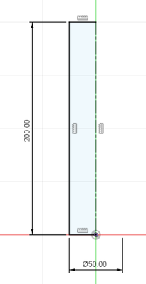

Step 1.
Sketch this Rectangle...
Step 2
Add this Construction Line
Step 3.
Add this 3-Point Arc...
Do you observe any duplicated dimensions in my sketch?
Attach your progress file here for next set of steps.

TheCADWhisperer
@info9BFML
Your sketch doesn't look like my sketch.
I toggled to Centerline while you toggled to Construction line.
I use Ø50 dimension while you use R25.

TheCADWhisperer
@info9BFML
Start the Dimension command.
Pick the Centerline.
Pick the lower left endpoint.
Fusion will automatically create a diametral dimension because you picked centerline.
