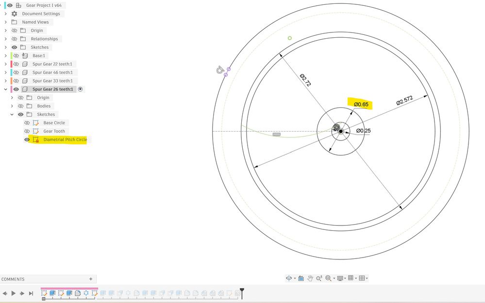

I found your video clip very helpful!!!  Here are the few issues I ran into:
1.  I am not familiar with deleting a face on a body.  I was successful with one attempt, but not on this one.  It didn't effect this part, but I would like to know more about deleting a face.
2.  I don't understand why reducing the size of this circle say to .55" makes the drawing fail:
3.  Lastly, can you provide more info on how you used the long select to select sketches.  I have not seen this before.

TheCADWhisperer
@richardsalzman
For this image to be useful for diagnosis you should have expanded this in the browser and expand the Bodies folder to show that it is one body.
Without additional explanation (or the actual file) I don't see what you are referring to as a "failure".
But that certainly doesn't look like a logical size for the Pitch Circle.
Maybe we should have gone through the step-by-step process of creating a gear.

richardsalzman
Sorry, I forgot to attach the file.  For starters, the gear was created with the Add-in Spur Gear plug-in within Fusion.  If I reduce the diameter above from .65 to .55, I can no longer apply filets.  I don't see what is happening.

richardsalzman
Thanks for the excellent explanation.  The problem I was having is that when I reduced the radius of the center from .65 to .55, the filets had error as shown below.  I am quite certain that this happened because I did not join the "spoke" to form one body as you pointed out.  I was not aware of the fact that if it is one body and you delete a face, it will heal itself.  Really cool stuff!
The reason the distance between centers for the gears is too large is because I changed the gear design (modulus, tooth count and root filet radius) and have not updated the drawing to reflect the correct distances.  I am machining these gears from aluminum and wanted to machine one first, then update the rest of the gears.  Below is the first gear I just machined.
