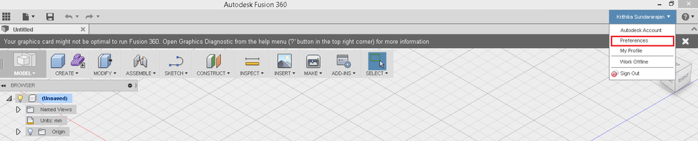

Hi emvioeng,
By default, the ASME template uses Third Projection Angle and ISO uses First Projection Angle. This can be changed before creating a drawing.
To do this, go to Preferences > General > Drawing. If your Standard is set to 'Inherit from Design', change that to ASME/ISO. This will display Projection Angle as an additional option. By checking 'Override or Restore Defaults Below', this value can be modified.
Please let us know if this addresses your question.
Thanks.
Krithika

The projection angle has to be set before creating the drawing. Once the drawing has been created it is not possible to change the projection angle in between the creation of drawing.
Even if you change the angle in between, this changes will be applied only to new drawing (please note: not new sheet).

If you use the ISO Standard in the creation of any new 2D Drawing, it will be "by standard" first angle projection.  If you want third angle projection, select ASME as the Standard.  You can still select any Units you desired.  Once a 2D Drawing is created, the projection angle cannot be changed.
So the answer to your question is the Drafting Standards determine the projection type and you cannot change that fact.

As I said, ISO and ASME are both standards each associated to a particular drawing projection angle, this rule should not be violated.   If you want to change your drawings to a different projection angle per Standard, which is not advised,  you can do this by adding a check mark, as indicated, and then change whatever you desire.
