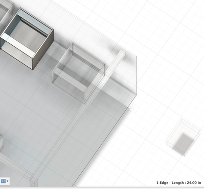

This post answers how to change the dimensions of a single component (without other components being considered) like nailers, bottom, top, for cabinets: https://forums.autodesk.com/t5/fusion-design-validate-document/after-copy-paste-new-how-to-dimension.... What I'm trying to do is take one cabinet I made and use the paste new function to create another longer cabinet next to it. How would I do that?

You can see here the second cabinet that I am trying to make longer

Hmmm...it appears to be 24inches for me; it was showing up as 23.75 for you? See bottom right

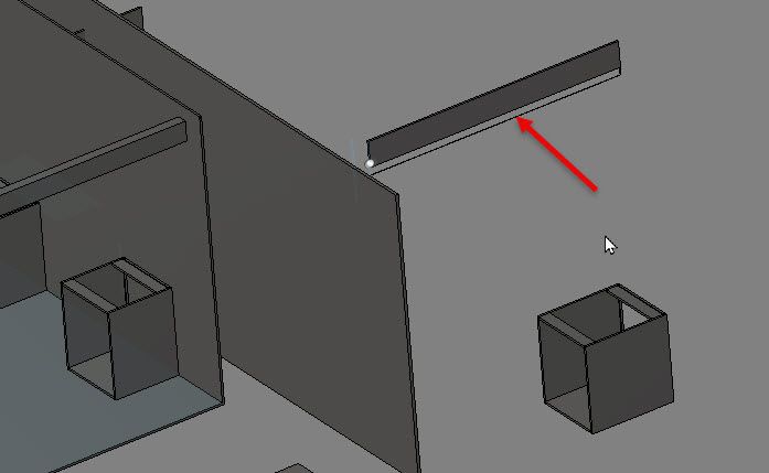

Okay, so I tried that approach, and this will be a good thing for me to know and understand. Is there something I did wrong along the way such that it ends up like this?

Sorry I did not examine the way you built the cabinet -
The timeline reads as make offset plane, and then make midplane, before using the midplane to mirror side one.
Then the rails were made, I presumed, extrude to object, but maybe you did it some other way.
That pic shows that the sides and rails are using different parameters.
Both cabinets have the same initial timeline, so if I picked the wrong one to modify, change to the other one.
When you see fit to use a Move command, stop and ask us for the best practice.  25 plus moves in the opening screen means I resorted to answering just the simple question.
