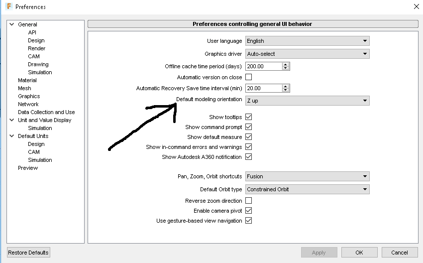

I have uploaded a STEP file and it turns out the coordinate system is different form what I want it to be now.
In the screenshot below you are looking at the bottom of the part. Obviously I want that to be oriented to the bottom, meaning the Z-axis is where the green axis is now. Is there a way to reorientate the coordinates? Or should I have done that in the upload?

Select the body in the viewport. Right-click to bring up the marking menu ad use the move tool to rotate/pivot the part into the desired orientation. The is an option in the move dialogue that allows you to pick the pivot point.

PhilProcarioJr
@Anonymous
The button you clicked to set the pivot point...after you click where you want to pivot around you need to click that button again to set it then you can rotate.
Aslo I suspect you want Z up and if that's the case you can set that in your preferences. Click your name -> preferences set default model orientation. This will not convert scenes you have already created though but will effect all new scenes.

It was the set pivot point, which did the trick. thanks!
Phil: the z-axis is up by standard. This was an imported STEP file with a different orientation which I wanted to change. The reason i couldn't change was that i dind't set the pivot point correctly.
