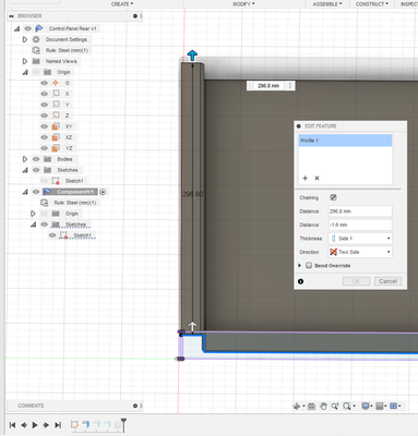

For some reason OK is always greyed out when I try edit an existing contour flange.  I just want to change its length...
Any ideas why?  I have to delete it and add it again at the new length and it works fine.

It seems to work fine here, although the timeline looks different in your image and the uploaded file.

I think the timeline looks different as I had just that component activated.  I just tried again exactly as you did in your video and OK is still greyed out.  How do I make one of those fancy videos?

Capture Keyboard Events may help figure out why it's happening for you and not me.  Try downloading the file you attached to the thread and see if it behaves the same.  You may also try closing and re-opening Fusion 360.ScreenCast.jpg

@etfrench Good idea...  Restarting F360 fixed the problem so all good now.
