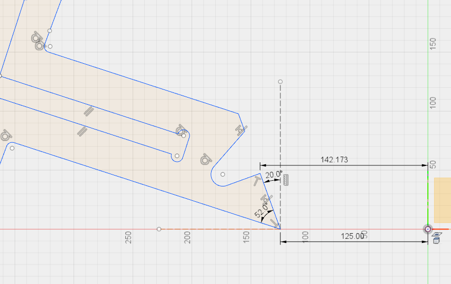

Hi -
I am trying to fully define a completed sketch - when beginning to add dimensions and constraints, I get
over-constrained errors - even tho the sketch is "new" - all blue lines. I projected edges from an imported
rhino file, then created a new sketch and projected to create new lines, then broke all links...wonder if
this is why I am having problems?
My file is here:
http://a360.co/2y7v6Lb
Thanks for any help!
Andreu

@Anonymous,
You just need lots and lots of dimensions and constraints to fully constrain this sketch.  I only did a small corner of it, but it went from this:
to this:
It's more complicated because everything is at an angle and you will have to have lots of angle dimensions to fully constrain this.

Thanks Jeff, I actually did just that and got it to work, appreciate the input. - Andreu
