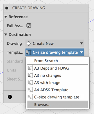

There were indeed a few changes made around templates last year.  As you mentioned, in the past a drawing had to be associated to a design, then if you set your drawing up the way you wanted, you could export as a template for re-use later.
The same functionality is still available, it's just been moved.  If you have a drawing set up the way you want, and want to use it as a template, you can click File > Save As and change the Type to Drawing Template (*.f2t).
But, if you already have a template set up the way you want (even if it's in a different project) you can use it for new drawings, by browsing to it when you create a new drawing:
Once a template is created/saved it can be re-opened and edited for future use (these changes won't be retroactive to existing drawings).  As a first step I'd recommend getting the template set up with logo, notes, etc.  then move on to the placeholder views.
Hope that answers your question, if not please let me know.
