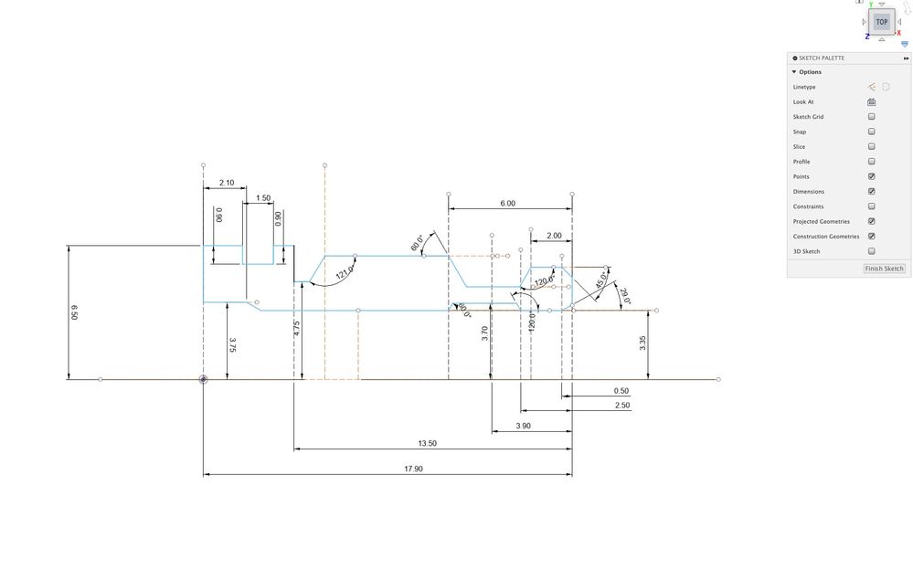

Hello, I cannot create drawing from design because the OK button keeps persistantly disabled in the create drawing dialog. I tried several approaches without success. Who can give me a hint?

activate body!

Hi, Thanks so far. That's a step forward. Please find the result in the next attachment. I now see the 3D-Object, but not the underlying sketch.

Warmingup1953
then opt for Automatic Drawing?
P.S. I love the new Automated Drawing (Cloud) option!

Hello WarmingUp1953, I understand your approach.
But I'd like to see my original sketch "Sketch1". Is that somehow possible?

I'm goingcross.jpg to use my terms specifically...You want to create a Drawing that includes Your Sketch 1 as a viewed item:
Message 9 of 12
Warmingup1953
Then this is an option: ( You may need to select Top or front or some other view)Draw44.jpg

Do not forget, you can now toggle sketch lines, from the model, to be continuous line type.  Document settings, second tab from left at the bottom.  Look for the subtitle Sketches.
