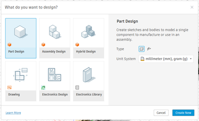

  • So I have a f3d file open and I create another new file.
  • I select 'Part Design'.

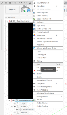

  • I right-click the component or body in my original file and select 'Copy'.
    In my new file there is no paste option?

Part files, have new restrictions.
Change the destination file to Assembly type, or
Change preferences to Default all files to Hybrid.

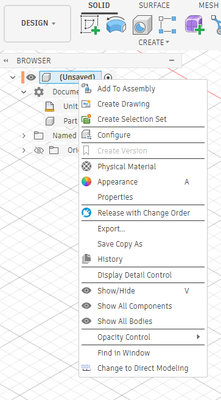

Ok, so 'Paste New' appears after I have added an empty component to the new file. So there needs to be at least 1 component in the file before you can paste in a component?

Change existing documents to hybrid in document settings (at the top of the browser).
Change the default design type in the preferences to hybrid. You'll have to close and restart Fusion for the preferences to apply.
