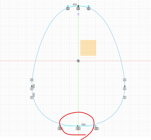

Hi all, I'm new with Fusion 360 and any 3D drawing program in general and I'm doing my first project.
I've create 2 sketches, each by doing half of the shape and then using mirror tool.
I added the black joint on the right one (in black) so I closed the sketch.
Now If I try to do a open/close spline curve, I get strange behaviour:
I could close the one below and the one full right (which are now visible, were not in first capture).
You can see the far left has changed shape and the second is like it didn't take the bottom line as closing line.
Hope somebody can help with this issue. Thank you !

The white dot represents that it is open at that point. I don't know if you created two different splines at that point or if that is where you mirrored the spline. Usually you can just drag the point until you get a blue box around the point and that will close the spline.

I could close one with the "blue box" help but not the other (no blue box). Where I can't close, It's effectively the point where I made the mirror but since I started at 0;0, and used the plane for mirror, I don't understand why the mirror makes 2 different points. Also if I look at coordinates while selecting the point, I see X:6.073E-05. How can I set it to 0 ?
Also last strange thing is that I've a single orphan point at sketch center and I can't delete it. If I select it and I click on "delete", it doesn't delete and also I can't select it anymore while "delete" window is opened.
For the one I could close, here is the "shape" when I close spline curve:
I don't know why I get this ?
Thank you for your support

Here is the 3df file. What I want to achieve is to make a 3d object using the sketches. I could do the far right, the bottom but I can't close the first and second sketches. The "Cote" and "vertical" lines will then be used to make the "path" of the 3d object (don't know how it's named, I'm looking at a non-english tutorial for now).

If you zoom-in there are open sketches.
Screenshot 2022-12-20 at 8.56.57 PM.pngScreenshot 2022-12-20 at 8.53.56 PM.png
Closing them will fix the problem.

Thank you for images but how it is possible to get this zoom details ? When I zoom at maximum I don't see such a distance between points.

You can use Zoom Window from Navigation Bar

I can't move the point after zooming deeper:
I move the point, then I click OK and once clicked, it keeps at the same place. Do I miss something ?

The point(Green Colour), the one you are trying to move is Fixed.
Use to Unfix using Constraints.

This is the part where the COINCIDENT restraint is attached.
Here is the same phenomenon.
I don't know what is wrong with this part, but it sure doesn't seem to match.
I have no choice but to erase one side and re-mirror it with a Virtical constraint where necessary.
Vertical restraints are attached.
Mirror.
