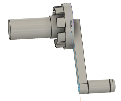

I hope I can ask this question correctly. I have the bottom plate with points. Those points set holes for screws that will hold the sides on. I want the thread to go into the sides. If I put a hole on the point, it will only let me go down and not up. The sketch plane is between the bottom and sides. The sides sketch plane is in the center with the bodies offset to the edge of the bottom sides. I guess I could create a sketch on the bottom of the side bodies, project the point on to it, then do the holes from that. Is there an easier way?

This was more of what I call a whiteboard project. When I started, I was not sure of where I was going. The spool is for a weed trimmer. I was making something that I can put in my vise, stick a spool, then wind it. I was also working on how to 3D print it without a lot of support. That is why it is in pieces and flat. The shaft has cogs that spin the spool. The shaft is only held by sideward pressure on the handle, this is not there yet. 🙂 The next step is for a hole and threads, that the crank will screw into. Have not tried anything yet, I think the crank will be two pieces. A flat bar with the male thread sticking up when printing. The other end will have a hole for the handle. Then it can be printed round with the male screw sticking up. As I am typing this, The end (what is on the bed) can be bigger, then I can print a hollow tube that inside will spring on the handle shaft and be captured between the flat end of the handle and bar. In the more information than you care, I will post my solution. 🙂
Message 7 of 9
paulMVAJU
Here is an untested try. 🙂
