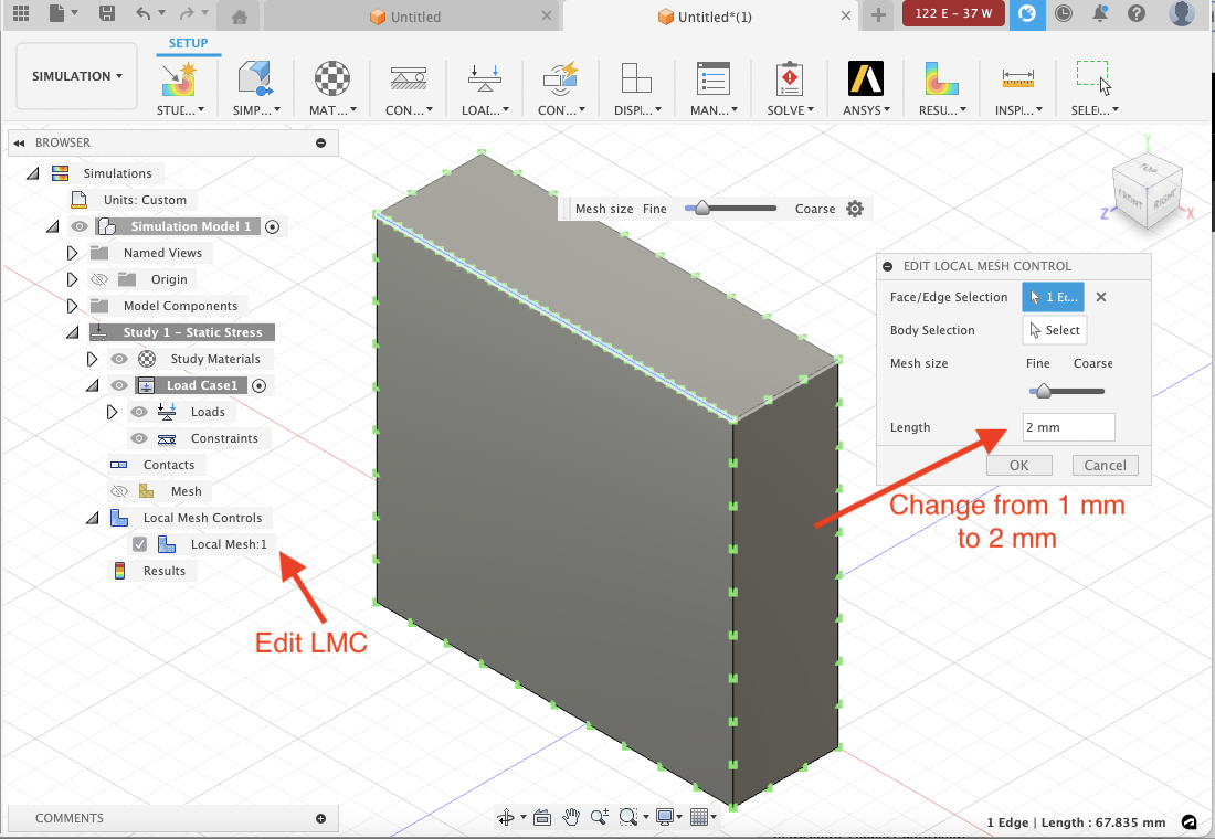

It seems like when I'm in Simulation mode and set a local mesh control, to, say, 1" on a face, then there is no way to edit that to, say, 2" on a face. Is there someway to edit or remove a local mesh control after it is set the first time?

Hi  brooknorton1,
Both of these are possible.
1. To edit it from 1" to 2"
  • Right Mouse Button and Edit the Local Mesh Control from the browser
  • Change the Length field from 1" to 2"
2. To edit or remove a local mesh control
  • To edit please see #1
  • To delete Right Mouse Button and Delete from the browser
Best regards
shekar
