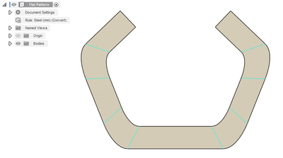

I think you'll need to create a different way...Here is my quick goScreenshot 2025-10-30 215833.jpg
NB. Ignore the file name
