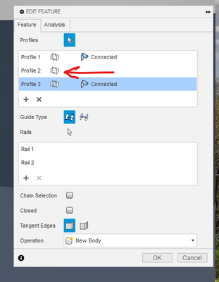

So lets roll the timeline back at the very first surface you lofted and look at the isocurve analysis:
Without actually looking at the loft dialogue we can observe that the loft was created from a curve to a point. Lofting into a singularity (the point) creates curvature problems and should generally be avoided.
This single surface can be thickened to 1.5 mm, but should terminate in a single edge at the tip. The odd shape created by the thickening operation is yet another indication that something isn't OK with the surface.
 Now lets take a look at isocurve analysis of the second surface:
Do you see the discontinuity in the curvature comb of the surface ?
That is the result of the 2ns loft profile:
Do you really need that ?
Less is often more!
The third surface is even worse. Here you also are not constraining all boundaries of the surface:
Also, there two surfaces are connected without tangency or continuity. The reason is that you are not even given the option in the loft dialogue is that you selected a curve for Rail 1 instead of an existing edge of the bordering surface and because the 2nd profile is not tangent or continuous to the "other" profile.
