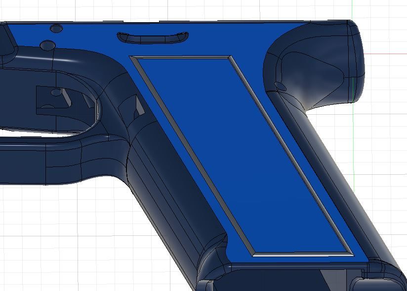

Hi everyone.
I'm still new to Fusion 360 and I found a workflow problem.
I create a sketch on the face of an imported .stp file I have.  My sketched area is placed on the flat face of the object but I run into a problem soon after...  Here is what is happening.
I want to draw my own 2 dimensional area on the flat face of an imported .stp file. I easily can sketch out my area. I then extrude it up .5mm . No problems at all so far. I then fillet the edges to make them round.  First I fillet the corners of the extruded face. I then do one more fillet  on the very top edge of the raised area.
I am so far still able to collect the face of this sketched area I made.  But after I extrude it back down .5mm (I want to just be left with a bordered area), I can't select the inner face of my sketch.  Fusion 360 is ignoring my existing borders/edges that are left.    Even if I try extruding it down only a little bit.   I guess I have to create an inner face first?   Shouldn't the raised/filleted borders that are still left create an inner face for me?
My imported .stp file is blue instead of light grey like I see online.  Does this mean the file has it's faces reversed or something?

a few comments:
  1. blue color.  STP supports color attributes, so most likely this color is defined inside of the STP file itself
  2. the problem around selecting faces for extrude.  This is because at this point in your video, you create a New Body, with a depth of 50mm:
    Did you mean to join this shape to the main body?  Then, later, when you cut away the inside face, the depth is also set to 50mm, but because this is a separate body, it just removes all that inner volume:
    If you were to isolate that silver body, you would just see the the thin silver ring.  There is no surface at the bottom, you have removed it.  So, selecting the face for further extrude just goes to the main (blue) body face.
If you share your design here, I can illustrate on that model.

sorry, you are right.  It is .5 mm, not 50mm.  But my point is the same.  If you extrude by .5mm and then cut away by the same amount, the result is as in my simple example.  There is no face there to select - it is just the outer ring.
If you could share your F3D file here (not the step file), I can show you on that, but I'm certain that this is the problem.  Either you should use Join in that first extrude, or reduce the cut by some amount so that it does not penetrate all the way through that second body.

Thank you. I've attached the file you want below please.  I tried on this one to "Join" on original and I still can't select the inner surface after I extrude back down. I believe that Fusion 360 is not allowing me to sketch on the actual surface in the beginning. So at the end, Fusion 360 doesn't think my sketch was ever on that specific surface that I'm trying to draw on. It will let me select the surface before I begin sketch.  But not sure if I'm truly sketching on that surface I want because the whole body turns the same color as soon as I select the Sketching tool.
Can you see if you can actually sketch on the true surface I want at the beginning? I believe that is the problem.surface.JPG

one more insight.  One reason why the extrude does not join to the body is because you have not activated the component that owns it.  You will need to do this edit in the design or component that owns the body.

yes, that is the issue.  Because your top-level design refers to an external component (FMDA DD17.2 V1.4 Frame), you cannot join to that body from that top level.  You have to open that design directly, and do your work there.  Then, Join will be enabled, and you will not have this problem.

Thank you. I have been mostly successful now.  I was before doing a weird thing I guess where I import the object from Data Panel but then create new component and if I have both, I can't perform operations even with top object activated. But I can sketch on the surface better now by only importing from Data Panel and just activated main object.
But, I get an error when I extrude back down .5mm.  I get "error with geometry....be sure there is a clear overlap".   Is this simply because of my fillet parameters and trying different fillet parameters should fix that?

most likely, yes.  I suspect it has something to do with the fillet radii used on the top face.  If I recall, you used 2mm, perhaps some other value will work.  What is your next step in this process?  Once you have cut out this face, and can select it, what do you plan to do next?  I'm essentially asking whether this cut needs to be exactly 0.5mm, or if some other value can work here.

I'm so close thanks to you. You have essentially solved the big problem. I am able to both edit the surface of this object and I better understand the fillet process. (I don't get that geometry error now).
The only weird this left is that even if I create "Join" option when I first extrude my initial sketch on the surface up .5mm. And then after I properly make fillets for the edges (I don't get the error anymore), if I extrude back down .5mm, I still can't select the inner surface.  I can only extrude down less than .5mm to be able to pick the inner surface.  In a tutorial I found online with the same exact file, the other person is able to extrude back down .5mm and still pick the inner surface.  Everything I'm doing is the same. My solution now will be to just extrude it back down .45mm which is working fine.
Would you know why this is happening as my final and last question?  Thanks for all the help today. You have been great.

Sorry for the slow response - day job got in the way...  I definitely saw this myself, and I don't know what causes it.  However, when I tried to reproduce it just now, it worked for me.  Model is attached.  Again, I have no idea why....

No worries.  I just simply extrude down -.49mm and the face remains correct for me to select. AND when I download your file that you said allowed you to do it all the way down and select, you were right!  So I just saved your file and will use that.
I talked to the original guy who did the tutorial and he questioned why my file opens blue but his opens grey.  So I wonder if I have a slightly different file from him.

yes, probably so.  In case you are interested, yes, the blue appearance is in the STEP file.  If you want to get rid of it, just open the Appearance dialog, select the material, right click, and choose Unassign and Delete:
