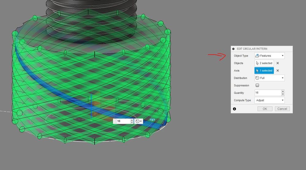

I was following this tutorial: https://youtu.be/F-6A489-Nf8?si=G5NgGgDROOpdpMgk&t=991
I want to create the pattern arround the bolt. I did everything like in the video, but the pattern can´t be applied. I always get the same error. Error: C-Pattern1 Compute Failed. I also changed the Quantity in the Pattern Settings Menu, and tried out other settings.
Can someone help me?
I have attached my file below.

In the video, the circular pattern selection is using "Faces" as an object type, and most of the time it fails depending on the model that you have.
What you need to do is always consider a "Feature" object type, it's much more geometry friendly.

Thank you very much for the fast response that solved the problem.
