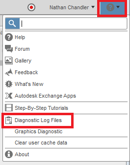

If these suggestions do not help, please submit a copy of the diagnostic log files. These will be useful to analyze to look for potential issues or a history of what is happening. You
I hope this helps! Let me know if you have any questions.

Can you post a copy of the diagnostic log files?
I strongly suspect there is a network communication issue occurring. If you review the About dialog box from the help drop down menu, what does the active plan say?
