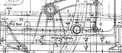

Relatively new user, and I don't really understand the constraint system well enough.  There are a couple of problems with my sketch:
- an arc is showing fully constrained, but the end of the arc does not touch the object it should be coincident with (there's a small gap circled in the image below), and there's no constraint showing on the end of the arc that would limit it.  I can't extend the arc until it touches or add a coincident constraint.  What's making it fully constrained? How do I fix it?  I also need some help with the corresponding arc on the opposite side - why isn't it fully constrained?
- There is an arc, line and spline that appear to be fully constrained but not showing as such.  I can't move any of the vertices, so the constraints must be there but they show as blue, not black.  Attempts to add further constraints either just don't work, give an "over constrained" error or give a "cannot compute" warning.
While we're at it, how can I tell what objects a constraint marker is referring to?

Here's the part I'm trying to model (note drawing is a mirror image of the photo):
Thank you for taking the time to reply.

The spline handles are not constrained.   Each one needs a length and angle and each point needs to be constrained
Message 12 of 22
jeffescott
4 constraints per point. Xy of point. Length of handle angle of handle.
Or xy point xy of one handle end

For the spline:
Bottom point: xy of point is coincident constrained by the length of the line. As a check, I can't move that point.
Length of handle is dimensioned. Angle is defined by the tangent constraint.
Upper point handle is constrained by xy dimensions.
Point is constrained to the corner(?). There's a coincident constraint there, but I'm unclear if that's the two lines or the spline and the line. Either way, if I attempt to add the constraint there, I get an "overconstrained" error.
I get what you're saying, but I'm not clear how to interpret in in this sketch. Which of the 4 constraints am I missing and on which end?
Any thoughts on the fillet and the vertical line? Why are they still showing blue? Again, any constraint I try to add gives me an error.

I refer to you second sketch in the first post. The “handles” are blue. They are not constrained. Try moving one end of the handle either up or down or longer shorter it will move. The spline will change shape. Each point along the spline has a handle. Each handle must be constrained. You can select fix and fix each point where it is. Not really elegant though.
The handles can be tough to see if nearly parallel to the spline
Create mew sketch then a spline with three points. You will need 12 constraints to fully constrain
Message 15 of 22
jeffescott
The handle which you constraint with a single dimension 1.05 does not fully constraint that point.   Try moving that point up and down

Ok, I finally got it.
Deleted the vertical line so I could focus on the spline. I discovered that a dimension from end point to end point fully constrained the spline. So the endpoints weren't constrained as much as I thought. Then added the vertical line back, and with some more constraint, got the whole thing done.
It appears this wasn't quite it. The 1.05 defined the length of the handle and the tangent constraint defined the angle so the handle was in fact fully constrained to the endpoint. I couldn't move those handles up and down. (as zero degrees) But defining the length of the spline as described above fixed the endpoints. Then the 1.05 dimension is from a fixed point at a fixed angle so it became constrained as well.

End points may not be fully constrained even if the line/curve/spline is shown as fully constrained.  We have yet to convince Autodesk this is a bug😊

the error appears to be in the solver.   If the constraints provide no solution but allow the solution to begin to converge on an answer. Then if the solution is within the set tolerance of the solver it provides that as an answer.  Results in closed solution indicated but not precise.
