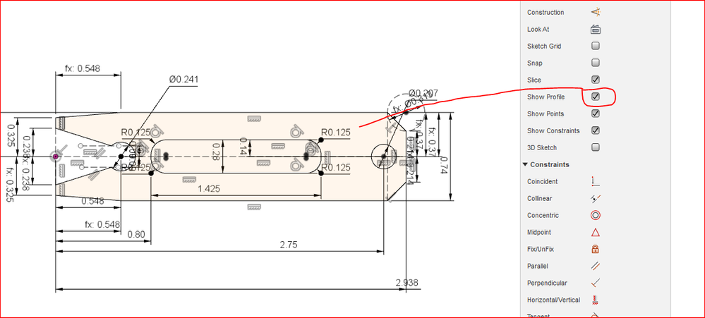

Upon exiting the sketch environment, trying to select the outline of this part does not work. Why? What do I do to fix it?
I suppose if the shape were not a closed outline that would explain it but where is it open?

Somehow the "show profile" setting for this sketch was turned off:
If you turn that back on, it seems to work OK:

Easy fix, sometimes we forget the little things, just turn it back on
