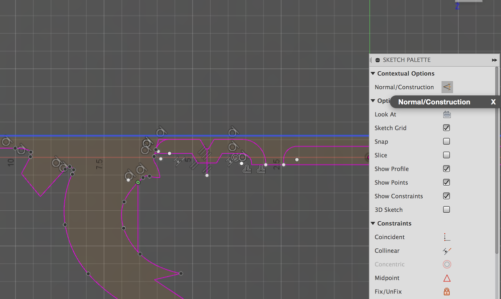

You can also, while editing the sketch, select a curve and use the Normal/Construction toggle on the sketch panel:
Coming soon to a Fusion update near you:  This same control can be used to "forward create" construction curves.  So, this will be modal, if you are in Construction mode, any curves you create will be construction curves, if in Normal mode, Fusion will work like it does today.
