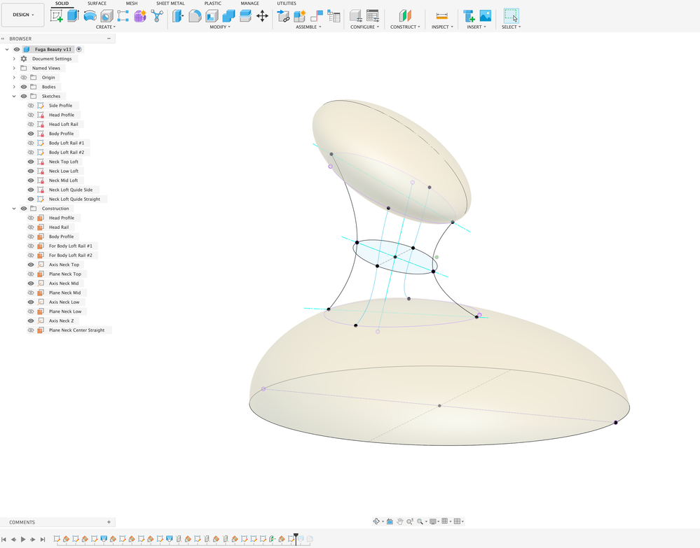

Hello everyone
Sorry to bother you with this very basic question but I've stuck on this step for 2 days, checked and re-draw the profiles and Rails many times but I still got this warning dialogue, When I start a new model and only draw random 3 faces and rails it worked, but whenever I came back to this model it just can't let me. Based on the message Fusion said the issue are always intersection of non monotonic, which I checked many times....Can anyone please kind enough to show me where I did wrong? Thank you.

kacper.suchomski
Hi
Fusion told you exactly what needed to be improved.
Make sure you have defined all sketches correctly.

johnsonshiue
Hi! There are multiple ways to do this. I believe Full Round Fillet offers the easiest workflow. Please take a look.

raymond_lin
Really appreciate to the feed back and full demo, I have to say it really blew my mind. Never thought of using the face cut as a solution, this really helps a lot!
Sometimes even those error messages looks clear but when I stuck on the same routine, even I checked many times and re-do, all I got was the same error. After this video I realized there were indeed many ways to do that, so thank you very much! I really appreciate.

Hello TheCADWhisperer, thanks for the fixed model, I noticed you (recreated?) the faces and rails I tried but all problems solved!  In your way I saw you face split the body for both body, It was very obvious this was very important part but I was unable to know why. May I know why is the split make the result so different?

TheCADWhisperer
@raymond_lin
I use Faces rather than Sketches whenever possible.
More options.
