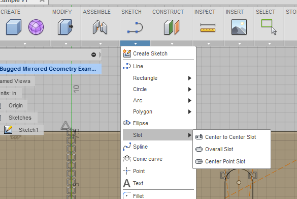

I'm not sure if this is a bug or a procedural problem.  Your input would be apprecated.
I'm editing a sketch that will later be used to extrude protions of the model.  I mirror some of the geometry from one side of the center line to the other to avoid introducting errors and to reduce work.  I noticed that the mirrored geometry is inconsistently used to allow selecting polygons to be extruded.  Where the original geometry would be used to demark or restrict areas in the sketch that could be used to select polygons for extruding, the mirrored geometry most often did not behave the same.  This causes mirroring of geometry not to be an option when generating geometry for extruding and forces the operator to create all new independent geometry that can be used for selecting polygons for extruding.
Please let me know if I'm doing something wrong procedurally or if this is a bug.
Here is my screen capture to demostrate the problem:
https://screencast.autodesk.com/main/details/a503cb2f-560e-4061-a63e-30c167461c3b
-Freeman

I took a look at your file upon opening and see the "Slot" loop is being consumed in the "Right Side" of the sketch. I delete this side on my end and re-mirror it. The "Slot" loop is not consumed on my mirror and functions mirroring left to right side. I am still looking at this trying to figure out what might be causing this on your install. I will follow up with you after I look into this.
Best Regards,
Don Warner
ADSKDJW4
Hello Freeman,
I wanted to follow up and mention I will report this to the development team as it appears to be an issue with the fillets on the rectangle that is created as a slot. Even though this works on the "Left side" when mirrored to the “Right Side”, I needed to edit the sketch and then use the extend tool to extend the arcs (fillets) together on the right side. Once I do this it works and wanted to supply this to you.
Another option would be to construct this shape on the left side using the Slot Command in the sketching environment.
I hope this helped?
