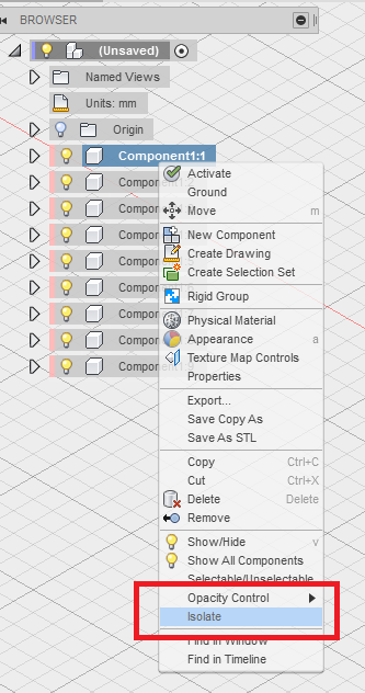

I am probably missing something obvious but where is the complimentary option to show all?  I like to hide all components except the current selected component to work on.  It is a waste of time to manually click on each light bulb.

Hi @Bertho_Boman,
Thank you for posting! Have you tried holding down the Shift key while selecting multiple components to hide? This should save a lot of time. Also, you can find "Show All Components" command by right-clicking on the top node in the browser. Please take a look at the screencast for more details. Please let me know if you have any questions.

The sequence to turn off all components except the desired one to edit is as far as I can see:
Select top level
Right click and select "show all"
Select the first component
Hold the shift key and select the last component
The "V" key will toggle all components to off state
Go back and select the desired component
Use "V" key to re-enable it.
That is a long awkward sequence!  What is needed, like available in many other programs, is: "Show only this component" right click option.

Hi Bertho,
Thank you for your response! Could you try "Isolate" command in the right-click menu? I think this works as you want. Please let me know if this helps!

Great!
That is exactly what I was looking for.  I was stuck in my mind looking for "Hide-View" commands.
