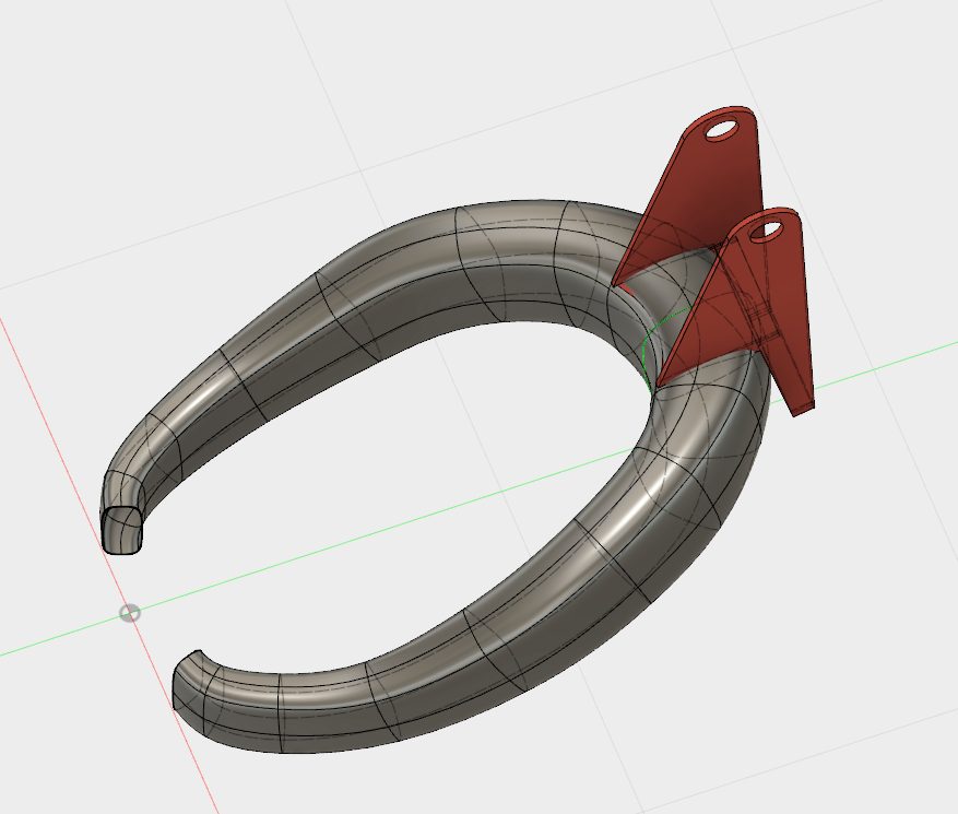

I am trying to modify a model I imported.  I managed to do everything I needed except modify the legs themselves.  I did a Prep to T-Spline and got a result I don't understand.
I attached the before and after models.
Was this the best approach?  If not what do you recommend I do?

But the answer to that is not that simple. There are many ways to skin this cat, T-Splines are just one and might not even be the best, or quickest way to do so.
Generally you might want to keep that part of the geometry that interfaces with the Radial fan assuming ( sorry 😉 )  that this is currently working.
You can simply trim those part off that don't fit (Modify->split body)  or delete individual surfaces in the patch environment.
Then you can either use T-Splines, or lofts either in the Model, or Patch environment.
I would go for lofts with a centerline guide rail.
Before doing all that in your current design with the timeline disabled use the align function and center all the parts on the top level origin and each individual component using the align function. That should establish somewhat of a baseline.
Then you might enable the timeline, so further design steps are recorded.

I can look up each one of those processes and advance in an incremental fashion now that I know where to look, so thank you for that.  It is interesting to note that I actually did the first step and trimmed the pieces and kept the top part as you can see below.

Progress.  I completely redo the Fan mount portion to make sure I had symmetrical and proper geometry.  So now I loft with guide rails?

I dropped the project for a while to expand my knowledge with a few other designs.  Unfortunately I am still running into issues.  I am at the point where I am trying to treat the thickened T-Spline body as a solid body but when I do, it seems to convert itself back into a T-Spline.
I just need to join the mount and fan duct but I keep getting an error.  Also deleting parts of the fan duct from the T-Spline edit does not seem to affect the body it is based on, although other changes seem to carry forward.
What path do I need to take?
Message 31 of 31
mtriffon
I figured out the problem.  The body had un-patched sections.  Patching them made it a solid and I was able to do the operations I needed.  Still need to make adjustments but thats another issue for another thread.
