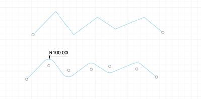

I have a big 3D model designed as a form, then thickened by 5mm into a solid and split into approximately 50 patches fitting into 25x25x25 cm boxes (the maximum size supported by the 3D printer). The following picture shows two such 25x25 cm patches:
Now I am looking for strategies for adding gluing hints to each patch. Do you have suggestions how to do this?

Is the concern primarily registration of the pieces, or keeping the curves in continuous alignment? My first thought would be to use sweep to make the edges into a kind of tongue and groove profile. This could be done as part of the splitting process if the splits are along a plane. Project-intersect in a sketch to get the splitting curve, then run a sweep profile(s) along the resulting curve to cut the pieces. Might need to allow some clearance for a glue line.

I like using a lap joint with locking pins.  The pins are just pieces of the filament.  You can either print the holes or drill them later.

Thanks for your suggestions. The Starfield build looks great but the model is much smaller and simpler (in the sense that it has no, or only small curved faces). A similar project is the 3D printed Lamborghini Aventador project on https://www.youtube.com/@lasersterling.
Lap joints and pins are an option but the material is quite thin (5mm) and large (each tile has an area of approximately 25cm^2). Lap joints are a great idea because I think that they are fairly easy to make: thicken the material on the cutting edges (=planes with a distance of 25cm cutting the model into 25cm^3 cubes) and then cut the joints into the thickened material.
I will also test the sweeping approach.
Generally my main concern is to keep the parts in place until the glue has set. Lap joints could help with this because I think that screw clamps can be used.

Also don't discount making separate extensions on you model for use in clamping parts during assembly that can be removed later- if that can fit with your design goal.

If the parts will be sanded and painted, then you can add temporary braces to hold each piece in place with clamps.  You could also use temporary forms over the joints to force them to maintain their position.  Cauls are used in woodworking for this.

@Oceanconcepts  suggestion of using sweeps brought me to the idea of using a chainsaw approach along the cutting edges (the one with the round corners is preferred because it works better with 3D print support):
I will checkout this too.
