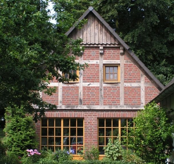

I am trying to create a brick wall for my model railroad. It is to be printed with a 3D printer and then painted.
Therefore, the wall joints must be a little deeper than the stones, to fill them with paint later on. I tried to create a single brick with joints around and use a rectangle patter. This works in principle, but makes the software slow and almost unusable.
Is there another approach to solve this problem?
Thanks for any idea

Are you looking for a single flat wall?
How large was the pattern ?
Can you share an image?

@TrippyLighting
This is how it should finally look.
The overall dimension is about 100 x 100 mm. One brick has the dimensions 2.5 x 0.6 mm without wall joint. The wall joint is about 0.15 mm.
My idea is to use a large flat wall as a base. Then I make cutouts for windows and doors and remove all unnecessary areas.
I'm doing a test with a flat wall right now. Then I draw the pattern as one long line. Then I use the Pipe tool and subtract the pipe from the wall.
That seems to be a workable way. I will do more tests tomorrow.

Simply create a rectangular pattern for each field using the principle shown in the screencast.
However, it must be taken into account that the resulting dimensions can also be realized in 3D printing.

I used different ways for different parts. And in the end i got it done.
But Fusion still has problems with large patterns.
Web would be great as a stamp and works fine. But it is limited to 99 elements!?
Here you see the first print test. Not so bad. If I don't forget I show you the final result. But it will take some time.
