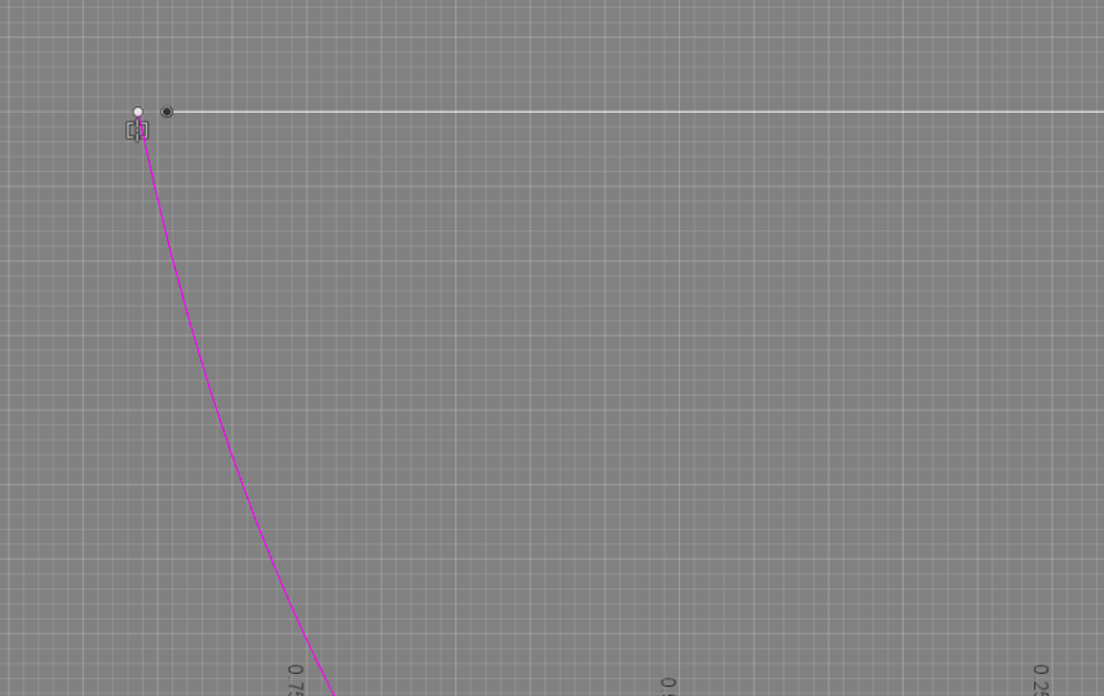

Yeah, I noticed that one myself.  The root cause is that the sketch lines in the sketch that generates that feature are not colinear.  The fix is to add that constraint:
However, fixing that only partially fixes the problem I mentioned before:  That transition between the part that fits into the body slot and the round neck.  Another post coming...

@jeff_strater, I have spent a few more hours playing with lofts. I am confused by points. In this drawing I did not project any points with the project command. Some of these drawings I have mad allow me to slide rails on the profile sketches. I am not sure what makes that happen. Between moving the connection points and changing the curves I can make anything I need. What I really need is to sort out how to make them slide on the profile sketches. I have learned that making the loft before the mirror is much easier to deal with. I know you are traveling. Perhaps you will get a chance to look over this sketch. Or anyone else for that matter. 😉
