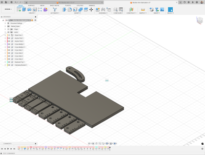

Where I am getting stuck is starting and extracting the parts and groups of parts from my
model to do  the machining operations. An example.
Here is the fully completed tutorial about facing a part on a 2D mill. I have finished it. I
understand exactly what it is doing and I have followed the steps to complete the tutorial.
Here is my completed model ready to begin fabrication.
All I want to do to start with is extract this highlighted part from my model and do a
facing operation exactly the same as the tutorial.
But I cannot work out how to extract the part from the model to do this, let alone extract
a group of parts; then auto lay them out; face them all; then individually cut them out of a
single sheet.
I have the skills to hand code this. I understand exactly what I want to do. I am very familiar
with fusion modelling. The fusion Manufacturing however is mainly a mystery because I do
not regularly use it. This is actually the first time I have ever needed to use it.
What I do know is that I have a finished fusion model and I need to take that model and lay
out groups of parts and machine them. I know that fusion is capable of doing this. I know that
fusion will automagically lay out the parts. I know that fusion will automagically generate the
code. What I don't know is how do I take my finished model and actually do it.
I am not asking anyone to do this for me. I am asking someone to step me through the process
to extract and lay out a few parts so that I can get my head around how it is done because I
have not worked out how to do this from the tutorials. Once I know how to do it with say three
parts, I can then go back and do the rest myself.

Ok here is what I have so far. Sorry for the delay in answering but I have
been busy the last few days.
I think I can see where this is going but I am not 100%.
I also have a question. The Keyboard Top component is 20mm which I did not
realise when I created the model. All other parts are 18mm and I will be using
an 18mm sheet of ply. Since it is only cutting it out and not cutting pockets,
am I better off leaving the top surface aligned with the surface and changing
the depth of cut to 18mm or should I remove it and do it separately? It doesn't
matter if the Top is 18 or 20mm.
Cheers
Andrew
Message 17 of 18
jeffescott
Just change your model to 18 mm thick if thats what you want to make
Message 18 of 18
programming2C78B
Do a quick push/pull of 2mm to the face, but if you program your Z as the machine table it wont make much of a difference - just a little bit of air cutting to start.
Please click "Accept Solution" if what I wrote solved your issue!
