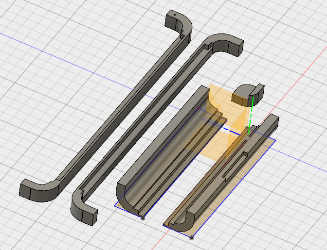

For Example this door (Currently Assembled in Sketchup)
Is composed of the following pieces (in fusion)
2.PNGH
So i cant CAM the door without rearranging all the pieces on the bed to be ready to be cut.

If I want to cut many pieces out of a single sheet....Check out the strategy laid out in this thread. note unique bodies need to be in components
  1. Make a route component called something like "plyCAM"
  2. Create a component under "plyCAM" called Sheet, this represents my stock I am going to use in CAM
  3. I make a copy of the components I want to use in CAM and paste them under "plyCAM", taking care not to copy any joints.
  4. Run nester script to lay out flat (it uses a joint)
  5. adjust position of components
  6. Continue with CAM
If I am doing a single part...
  1. Make a route component called something like "partCAM"
  2. I make a copy of the component I want to use in CAM and paste them under "plyCAM", taking care not to copy any joints.
  3. Can add any models of fixtures in here too if you wish
  4. use align, move, or a joint to flatten the part as desired
  5. Continue with CAM
Note: you can create the cam where the part sits and change the WCS to square it to the world without copying components.  I prefer to create the copy and square it to the world. For me it is convenient to turn visibility on and off when I switch between CAM and MODEL spaces and helps me stay organized.
