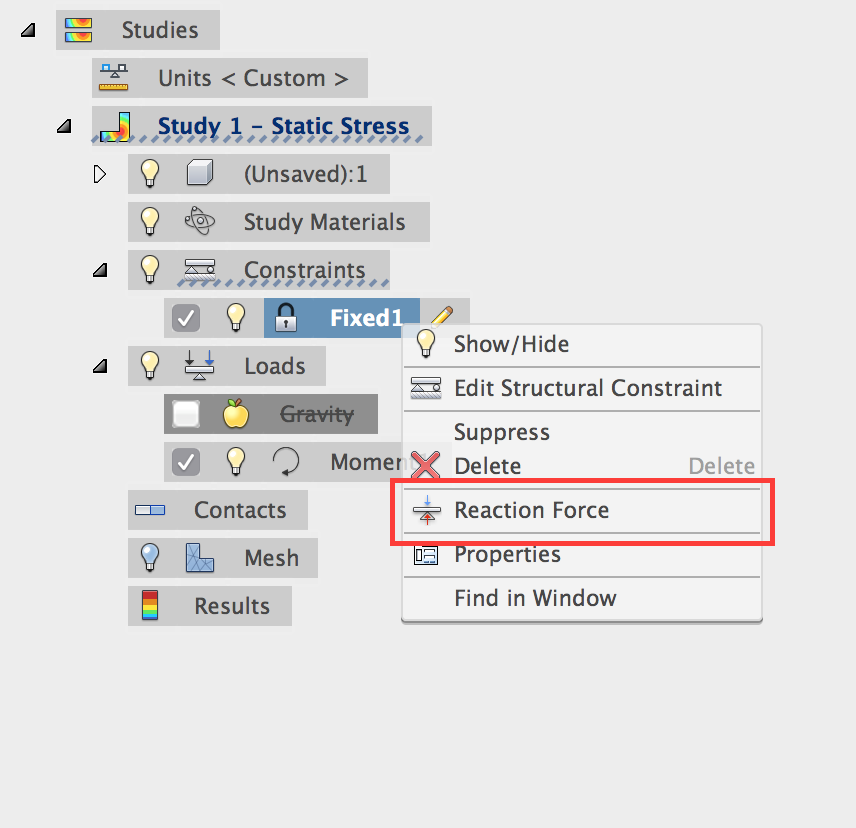

Another way you can check yourself is to examine the Reaction Forces on the Constraints after you've run the simulation:
The will break down the reaction forces along the primary axis. This can be helpful to understand how the load is being distributed.
