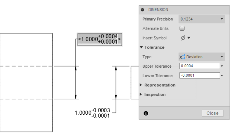

Good Morning,
Is there a way to get fusion to apply a ++ or -- tolerance in drawings? Double clicking a dimension only gives me the option to apply a symmetric or deviation tolerance, which seems to assume +/-. I understand I could use a limit tolerance, however I am converting another companies drawings from an electronic format for the shop floor, and would like to keep things as close to the original as possible.

TheCADWhisperer
You logic is not following standard math conventions.
neg x neg = pos
Lower limit assumed to be -  perhaps there should a minus symbol in the dialog box preceding the lower tolerance entry.
Hey,
Early morning brain fart. That makes sense. Thanks!
