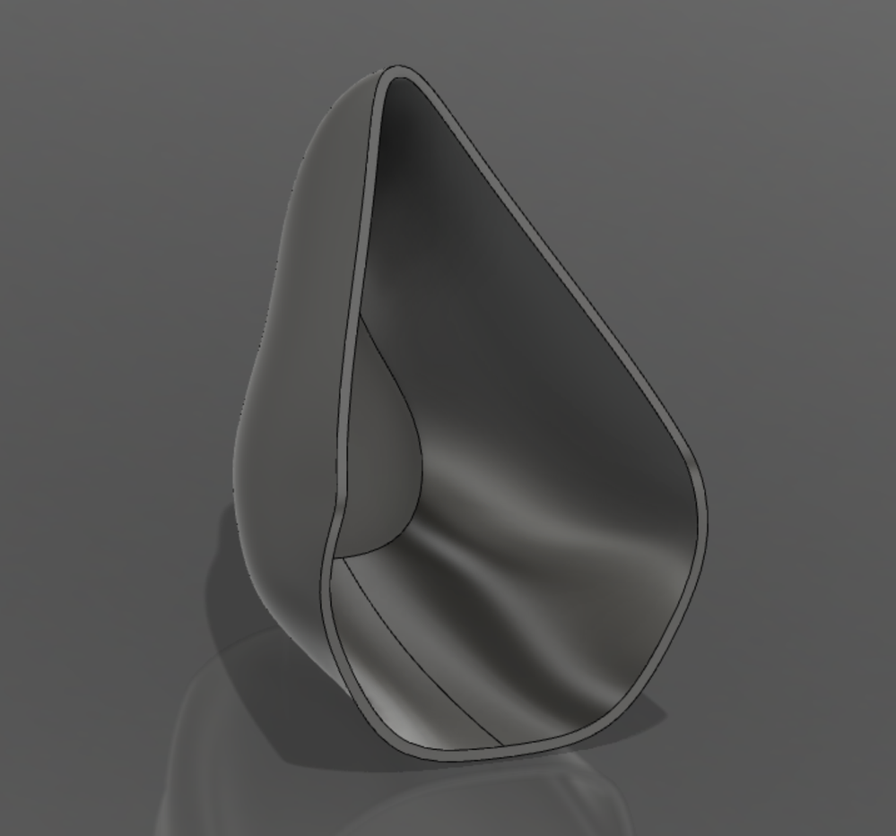

Well, I started over with my mesh model and tried to recreate your steps in making that mask as you shared with me in a PM.  So I was able to follow most everything you did up to the point when you used the shell command in the solid workspace to make the mask hollow.  If you notice from my version, everything seems to be almost identical until I get to the shell command.  Whatever thickness on the inside I choose, Fusion 360 just sits there trying to do the computation and eventually will crash. Ideas what the problem may be?  How do I shell this object to make it a mask of finite thickness?

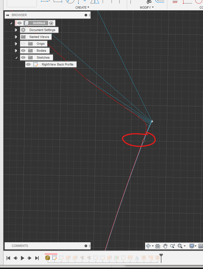

Your very first sketch has a spline with this curvature.  spikes in curvature at he ends are problematic.
the curvature is wonky because you pushed this control point up near the end with out adjusting the tangent handle
and also because you used nine control points instead of 3
I reworked that spline to have just 3 control points, now it looks like this
after doing that the shell worked.  I went ahead and reworked the spline in the second sketch as well.  the spline in the 3rd sketch needs some love also.  I'll leave that to you.  reworked file attached

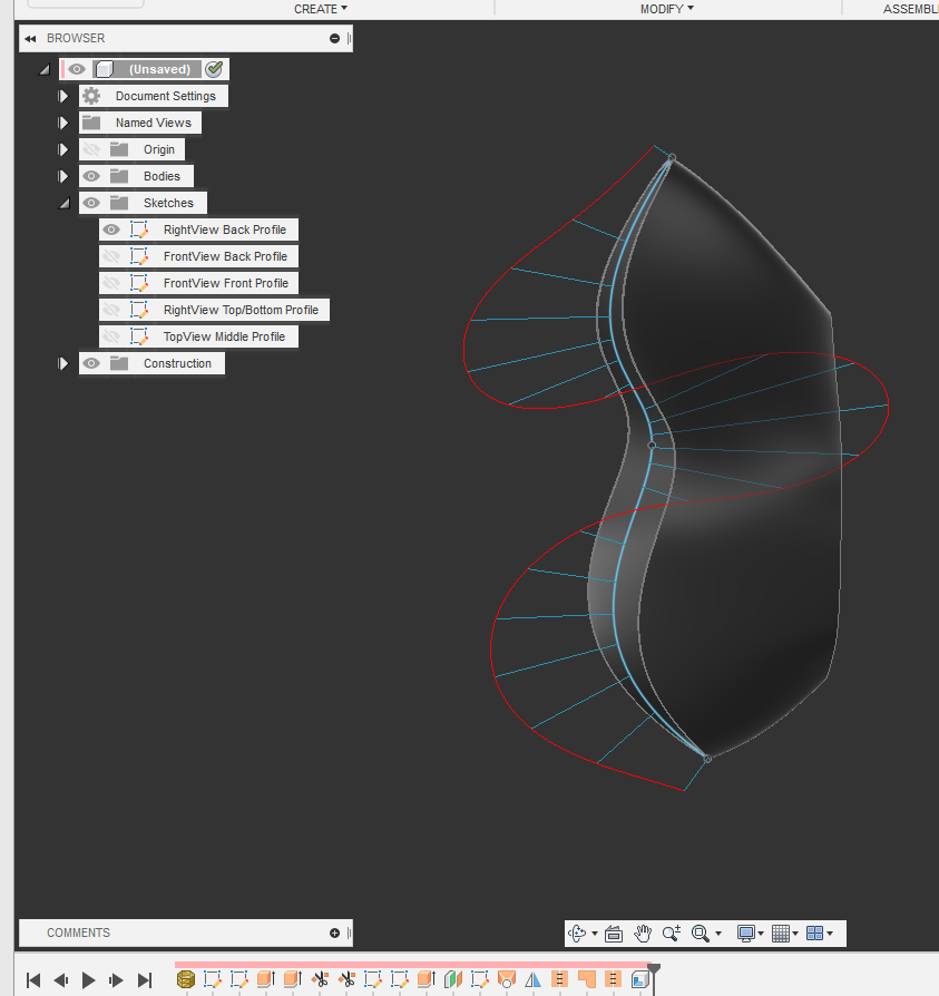

Message 6 of 12
mgianzero
Okay, I can certainly see that making a spline with fewer points (if possible) can make your model much simpler to work with.  So I can understand why making my first profile with only 3 control points is a much better t-spline.  I just didn't know I could get away with such few points.  So that you for that.
Regarding the third profile, you again showed me the curvature combs display, which I had read about, but don't really understand very well.  What exactly didn't look right at those two control points that you highlighted with arrows?  Are they not supposed to cross over the main curve itself?  I reworked it slightly which may be a bit better (see attachment), but I still don't understand what my problem or my goal is here regarding looking the combs display.  Sorry, but I'm learning here.
Lastly, I noticed you used the stitch commands several times once your completed your loft.  I think you combined the two halves in order to patch the center piece.  Otherwise F360 won't see that edge as one continuous front edge, right?  But then why'd you stitch the 4 bodies together before shelling it out?  Does that mean that when you stitch bodies together in the patch or surface workspace that completely encloses an inside space, that the model will convert to a solid body from a shell?  In a previous attempt at making this model (all with the surface environment) I made the entire shell and then used the thicken command instead of enclosing and shelling it out.  Is this a better technique?  It just seems counterintuitive to convert a surface model to a solid to then shell it out, when really all you want to do is "thicken" it, no?
You want to use the "simplest" geometry you can to describe the shape of an object, so use the fewest amount of fit points you can get away with. The curvature comb will look less "wobbly" in a good spline curve. It will also create a "lighter" surface. When your loft includes splines as the basis you create a NURBS surface. The shape of a NURBS surface is created by a quadrilateral mesh of CVs (control vertices or control points).
Fewer spline control points will create a surface with fewer CVs and as such uses fewer data and fewer computational resources.
Most importantly, however, a number of tools in FUoisn 360 are very sensitive o curvature problems, namely thickening and shelling. If you keep your curves smooth they these tools will perform much better.
Shelling a solid is indeed a much better workflow than individually thicken surfaces then hoping they will all combine happily into a thin-walled solid. Individually thickening surfaces can easily create near-tangent and near-coincidence situations where those solids border touch. Those are problems are difficult to workaround.
