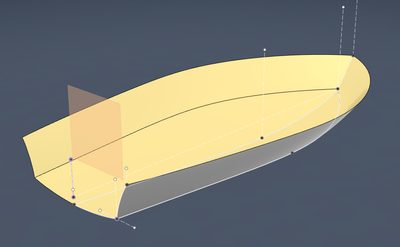

Here is my miniature project:
https://a360.co/40VQwd0
When trying to loft from the transom (profile 1) and keel-line (profile 2) along the two top-view rails, I receive the error message:
modelling error: rails cannot be tangent to profiles.
I fail to see where the rails ARE tangent.
Is there some way to analyse where Fusion 360 gets stuck?

You are probably using the wrong loft sequence:

Thank you Peter/Trippy. I have tried every thinkable sequence (or so I thought). Would you min sharing what sequence you used?

I did. I had a model with a timeline attached to my post 😉

I saw you did it "panel by panel" and then stitched it. That may be the better version. Nor sure why, but it worked. Thank you for helping me out.

It would appear that he lofted the side and the bottom separately and then stitched them.
But I cannot reproduce it.

Here's a quick video explaining the process :
