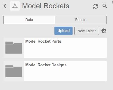

I have a project called Model Rockets. It has two folders, one for the parts, one for the rocket designs.
