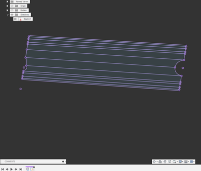

Looking at your screencast, did you try selecting\projecting the bend lines as well as the face?
Just a quick test on a design I have and I can project the bend lines no problem but the sketch is only available while the flat pattern is active. Is that what you need?
Here's the sketch with the body hidden in the flat pattern.

And here's your design, didn't notice you'd attached it! See attached file.
Also note, you have auto project enabled so you don't need to project the face again or you'll end up duplicating all the face edges.
