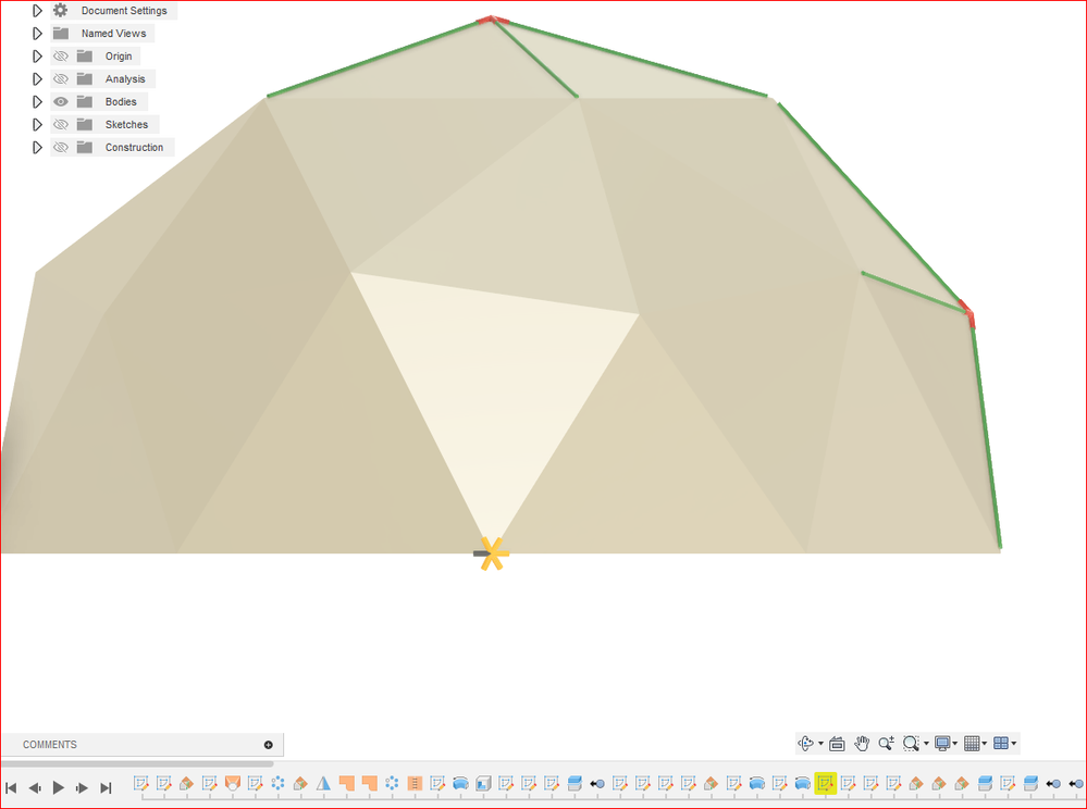

Been having issues aligning these joints and dowels for a geodesic sphere structure. I'm guessing it's an issue of circular patterns and axis points...been trying for days and it just seems to create a mess even more.
I know the length of the dowels are off in some parts but even where the length is proper, the dowel doesn't insert into the adjacent joints properly:
Screenshot 2025-08-19 at 5.32.41 PM.pngScreenshot 2025-08-19 at 5.33.31 PM.png
I've attached the file.

davebYYPCU
My fault, I (we?) presumed the 6 way joiner was symmetric - or at least I didn't check that it was.
So the first yellow joiner is the culprit, 5 legs are symmetric on it, (coloured yellow), but the black leg (@ 9 o'clock left view) is not
End result is that you have a handed 6 way joiner, but only on the hemispherical ring, 10 of these will assemble with 5 inverted.
The other blue 6 way joiners are symmetric but have differing angles to the yellow.
Sorry about that.  Fixed now, but no time to follow through with placements of the subsequent ones.  May have messed up that yellow sketch, and certainly the rest of the timeline will not behave without updating manually.
Might help...

davebYYPCU
I thought I sent the file, but seems the selection was a wrong attachment.  My edits to your file, all edits using the dome before the Shell.
As I understand it, the red and blue joiners in the pic are symmetric.
I used plane on Path or origin planes to cut the joiner mitre cuts.  I used sketch radial lines, similar to your axis’ that gives me a view normal to the vertex.  So the yellow / black joiner mitre construction on the left view - projected the panel edges, and the angles were under / over 60 degrees.  Made for some choice words, 4 individual mitre cuts.
Will send file later today.
Might help…

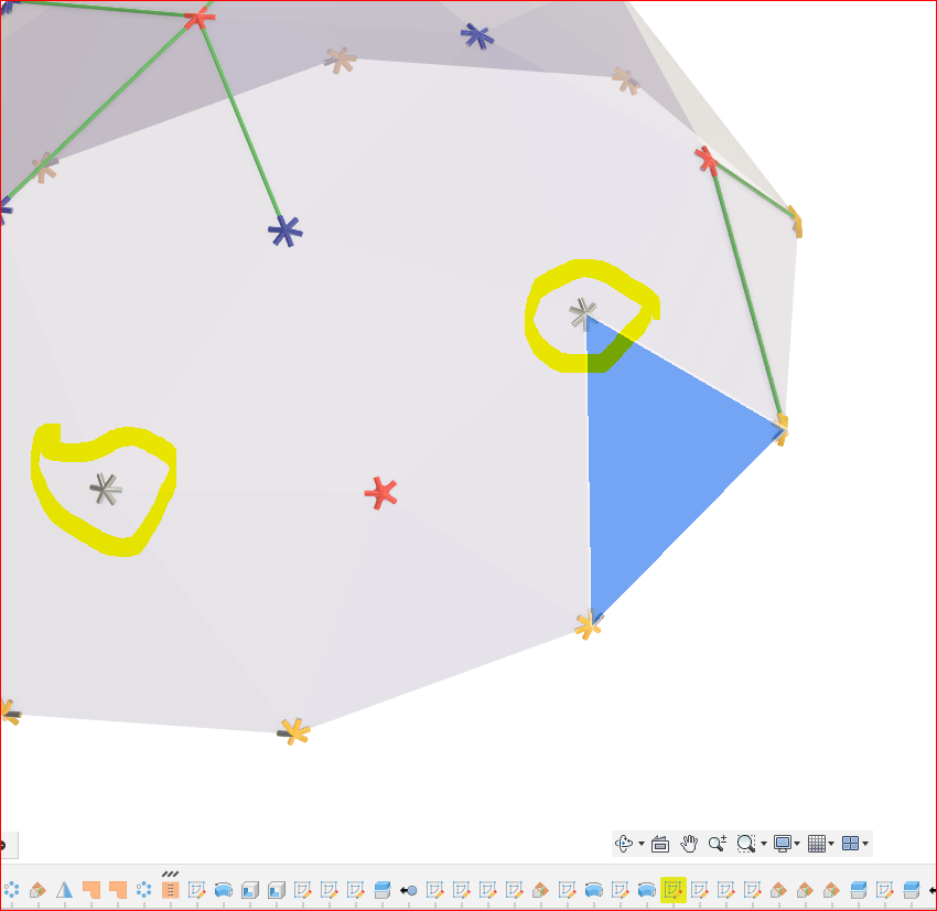

davebYYPCU
Attached here, but since this post I fixed another error with the lower blue 6 way connector, that involves the first triangle patch location.  two pairs at 144 degrees is correct, but the 3rd pair should be 148 ish degrees.
Might help...

davebYYPCU
Generally just Measure Tool, with crease lines from the surface half dome.  Where I was finding non symmetric angles, all originate from the triangle patches.  The 6 way joiners have differing mitre cuts - when done still have some symmetry.
Harder to describe it, than I thought.
