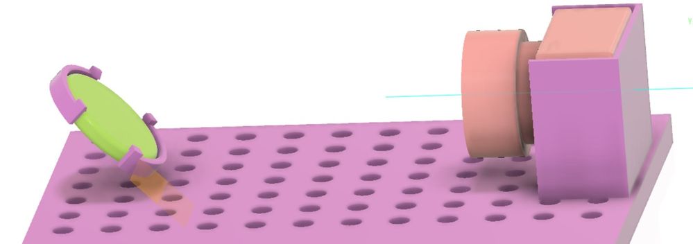

I need to align the center of a light source to the center of a mirror that was constructed on a plane tilted 45° to the light beam. I thought of using the sketch projection feature, but that appears to always project objects orthogonally to the sketch plane. Is there a clean parametric way of resolving this, or do I have to resort to brute-force trigonometry? Many thanks for any help/hint!Annotation 2019-06-21 235457.jpg

Have you made all the parts as individual components and followed Rule #1? You should be able to project a point on to a sketch created on the angled plane, then add a joint origin in the correct orientation. Then use a rigid joint between the back of the mirror and the joint origin.

Thank you! Are you saying that I should create the mirror and first place it orthogonally to the light source using a projected point, and only then tilt it using a rigid joint? Just making sure I understand...

After mocking up a simple model I think I see the problem. Does the screencast below help. You can't just use a constitution point on the plane because its orientation XYZ are not perpendicular with the plane so I created a sketch on the plane and projected the construction point on to it.

I don't really like the method above but if you are working with existing components you'll need something similar. Here's another way building the mirror inplace. This way seems a lot cleaner way of doing it with less features.

ahh, this is of course the way to go! Thank you so much for spending your Saturday morning (EU time) to help me; I feel grateful and indebted! I will post the project as soon as it can be shown without embarrassing mistakes. 😉
