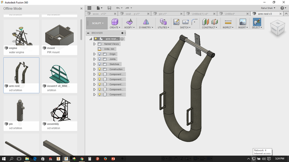

i am again facing the online issue
i have to go again to online mode , it shows that i am online, but on file manager it shows offline.
i am stuck here i tried to delete .xml file also. but it doesn't work.Untitled.png

Thanks for sharing! Found some very interesting things from your log files. So it seems that your computer is connecting than disconnecting from the internet. I note from your log file right when you signed into Fusion:
20161021T170844 D Entered into Online mode result: 1
This indicates that you successfully went into online mode right when you started Fusion. It also appears that you were able to successfully open, then save a couple of files. Then, about a minute later (based on the time stamps), I notice this error:
ET https://notifications.prd.fusionapi.autodesk.com/v1/channel/a360prod%3Agroup%3A7534079 6 Could not resolve host: notifications.prd.fusionapi.autodesk.com
Then from that point on in the log file it seems that there are a lot of Could not resolve host, as well as CloudBrowser failed request - exception: WinHttpSendRequest: 12007: The server name or address could not be resolved.
This leads me to believe this is network related. Can you tell me a bit about the environment you are working in. Do you have multiple networks connected to your machine? For instance, one theory I have is that your computer is dropping the initial network, then trying to reconnect to another one. Also, is you computer going in and out of sleep mode or anything like that where it might disconnect from the network? Are there any security protocols in place that might be disconnecting/forbidding access to these server calls?

ya ,
i am using college wifi, and it's connection speed goes on varring.
that might be the reason of that.
can you have any solution?
but what about the offline error. it shows online but still it is in offline mode.?

one thing i noticed that this problem occurs only when i am on unstable WiFi connection.
this offline online issue occurs when i am on my college WiFi or my smartphone's personal hotspot.
they are very unstable. they disconnect frequently.
but when i am on my home WiFi, which is quite stable connection, everything works great.
so can you increase network reliability then it will be very helpful, because i use mobile network frequently as WiFi is not everywhere.
also, still i could not understand why fusion is not showing offline logo when it is offline & server verification failed error.
